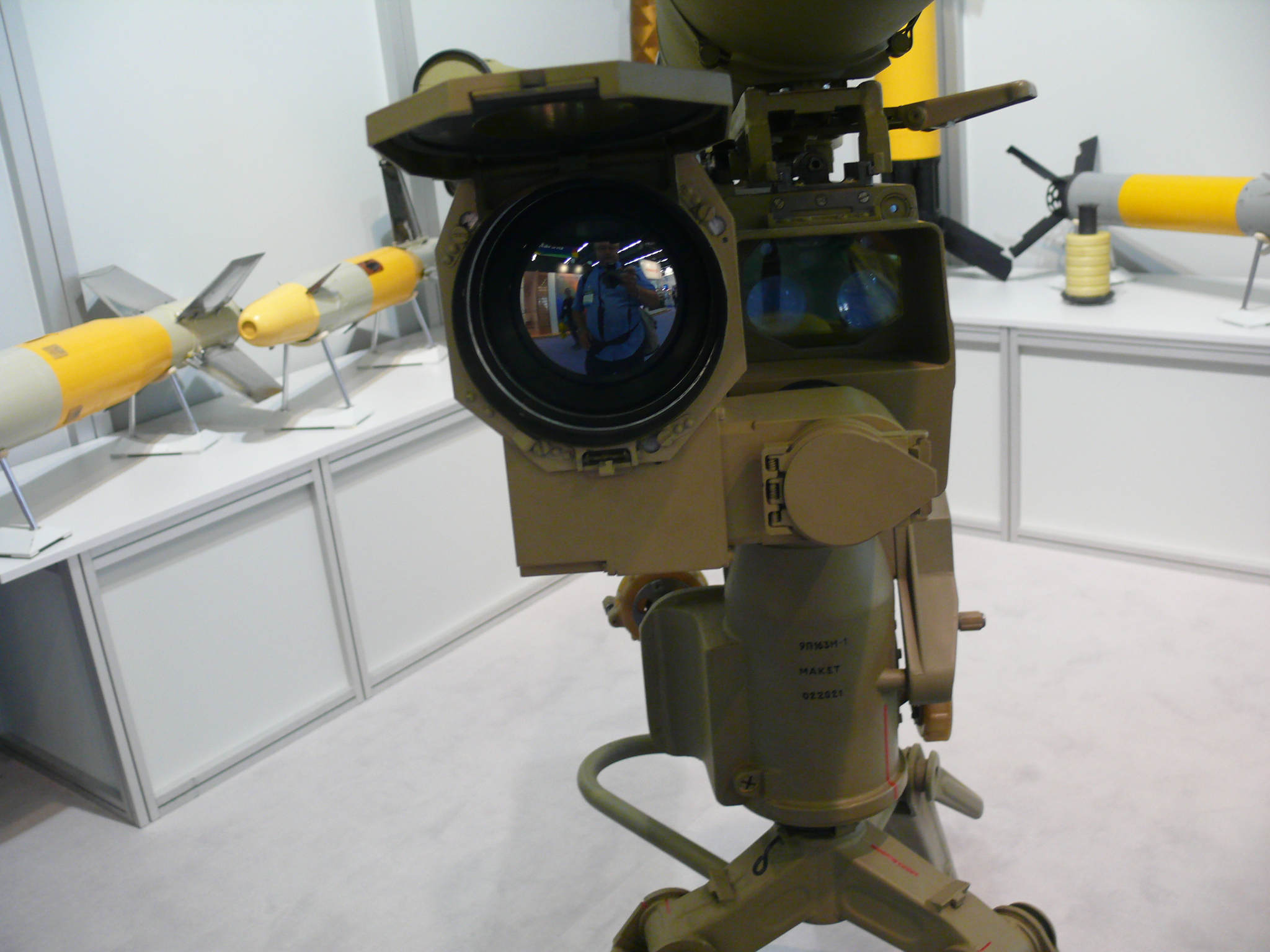

                  1PN79-1 – Thermal imaging sight for "Kornet" ("Kornet-E") PTRK

                    1PN79M-3 – 3-rd generation thermal imaging sight for "Kornet-E" PTRK

                      1PN79-M1 – Thermal imaging sight for "Kornet-E" PTRK and fire control systems "Malachit" for use in "Krasnopol" and "Gran" systems
                      انبوب التبريد مشابه للمستخدم في الميلان
