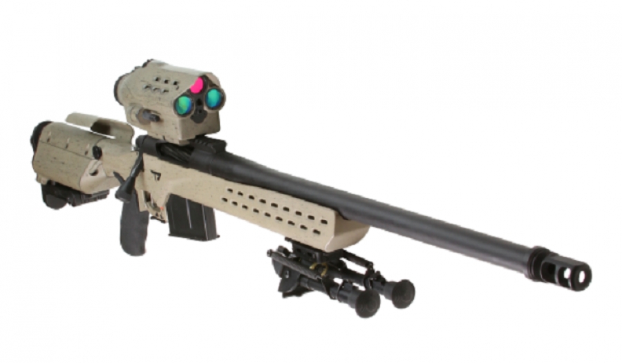

كشفت شركه Tracking Point عن قناصتها الجديده M1400 ذات الدقه العاليه للمسافات البعيده ، هذه البندقيه قادره على التعامل مع الاهداف التي يصل بعدها الى 1400 يارد ، القناصه M1400 مزوده بنظام Rapid Lok الخاص باضاءه الهدف والسيطره على اطلاق النار , وهذا يعني ان القناصه قادره على متابعه الاهداف والاغلاق عليها ، كما تتوفر القناصه على نظام لتوازن الصور والذي يتولى تقريب صوره الهدف اوتوماتيكيا لحظه اطلاق النار ، القناصه يمكنها ان تعمل مع نظارات اطلاق تنتجها نفس الشركه وتمكن هذه النظارات الرامي من استخدام القناصه من خلف العوائق بدون ان يكشف نفسه للعدو

TrackingPoint is please to announce the most powerful and precise Precision-Guided Firearm in its arsenal.  The M1400 338LM bolt-action engages and eliminates targets out to 1400 yards moving at speeds up to 20MPH.  The M1400 is a breakthrough in performance, cost, and weight in comparison to TrackingPoint’s prior extreme distance precision-guided firearms.  The M1400 is designed to give an Army squad insurmountable battle stand-off capabilities, and gives every squad a shooting capability that is well beyond the proficiency of today’s snipers.
RapidLok™ Target Elimination Fire Control System
As a soldier pulls the trigger the enemy is automatically acquired and tracked. When trigger pull completes, the target is instantly eliminated. Total Time-To-Kill (TTK) is approximately 2.5 seconds.  RapidLok™ Fire Control is image stabilized enabling fighters to lock targets with relative ease. RapidLok™ has an auto-snap feature that automatically adjusts point-of-impact to target center of mass. Also, target velocity is instantly measured and contemplated in the launch solution. RapidLok™ incorporates a laser-based Barrel Reference System that ensures shot-to-shot perfect zero eliminating error from shock, vibration, or environmental changes such as temperature, humidity, and barometric pressure.
Zero-signature Lethality
The M1400 streams video to TrackingPoint’s ShotGlass™ wearable glasses. The soldier can see the battlefield without putting his head behind the gun, and is completely unexposed and can see and eliminate targets as if he were looking in the scope. Soldiers can shoot over berms and around corners with an extremely high hit rate on moving targets at extreme distances.

Specifications
Lock Range: 1400 Yards
Max Target Velocity: 20 MPH
Tracking Precision: 0.047 Minutes of angle (MOA) (0.69 inches @ 1400 yards)
Barrel Length: 22”
Full Length: 45”
Target Lock Time: 1 second (includes all ballistics calculations and velocity measurements)
Time-to-Kill (TTK): 2.5 seconds, post-tag
Power: Dual lithium-ion batteries
Operating Time: 3.5 Hours
Zoom: 3 to 21x
WiFi: 802.11G
Ammunition: 300 gr Match or 280 gr LRX
Weight: 15.4 lbs
